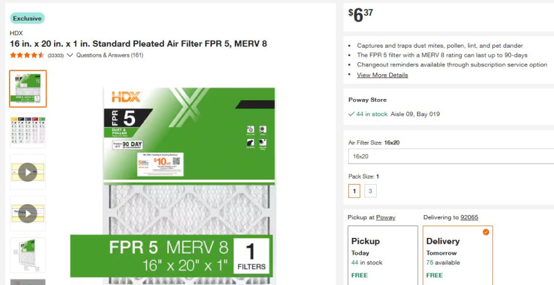

This is my planned go to solution for dust in the galley.
Furnace filter that slides under my Norcold refrigerator.
Already tested and it does not interfere with anything.
Should go a long way at minimizing the dust.
I had thought about just a piece of cardboard or other flat object, but that would effectively block any cooling for the refrigerator.
Testing it out in less than a week.
For $6.50 and free delivery, I hope it is worth the expense.

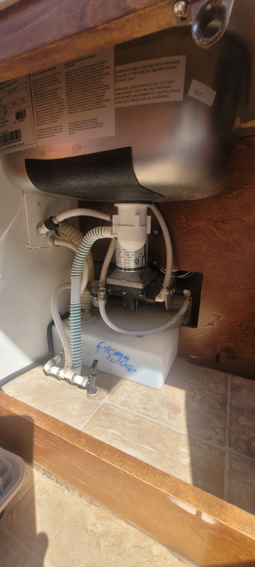

Installed the furnace filter under my Norcold refrigerator. Cleaned up dust under sink area. Do not have a solution for the wall opening under the sink which is open to between the galley wall where under T@G vent is.
Have a temp solution for the vent and look forward to a fix which does not require getting under my 2018 rig.
