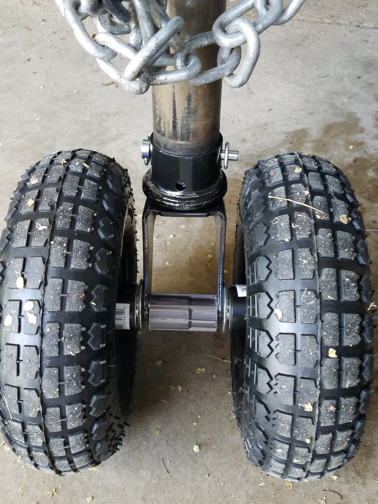

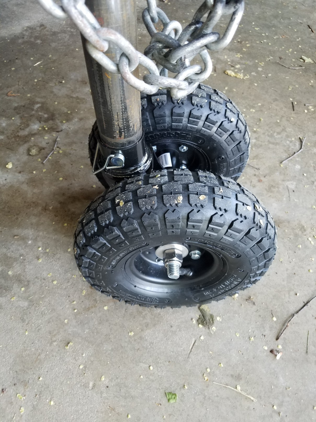

    Fourman110Fourman110 Member Posts: 229
    Completed the "747" jack wheel mod I saw on the t@G fafacebook page. Goodbye sunken wheel! 8.5" or 9" bolt, nylock nut, 4 stainless washers, short piece of rigid tube to make sure the forks don't bend inward,
    Two harbor freight 10 inch tires, and a new trailer jack wheel that I modified as I didnt want to take a chance on my old wheel (always have a backup). Hard part is enlarging the holes in the fork to run the new bolt through. Spendy drill bit and I wish I could have borrowed one.
    It is pretty big and didnt fit the tub with everything else I have in there so... next step for me is to make an adapter collar to mount it in front of the tub when not in use.

    After only five and a half years with my T@G, I finally made the 747 wheel (using 8" inflatables from Harbor Freight). I never knew how easy it could be to move my camper around on my uneven driveway!!! I hate putting in on and taking it off, but when it's on there it is glorious!
