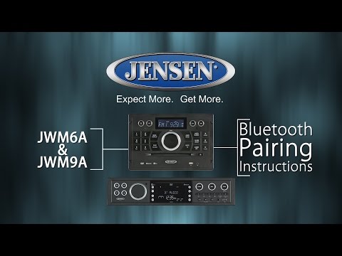

Mejane...not sure what year or model Jenson you have but if you have the model that comes Bluetooth enabled the following link will give you some direction. If the Jenson is not Bluetooth enabled your going to have to jump through hoops to make it happen.
https://m.youtube.com/watch?v=O9iHkjCtE38Tom

@TomD this is nice, I did listen to music via bluethoot with my tablet and phone on the jensen, but did not know that a full control app existed!
Thank you.
