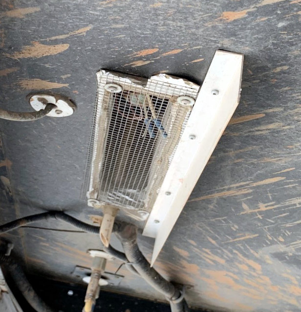

Here is the belly vent on the 2021 T@G XL - has the Aluminum L in front of the leading edge of the opening, which is an advantage as another surface for velcro.

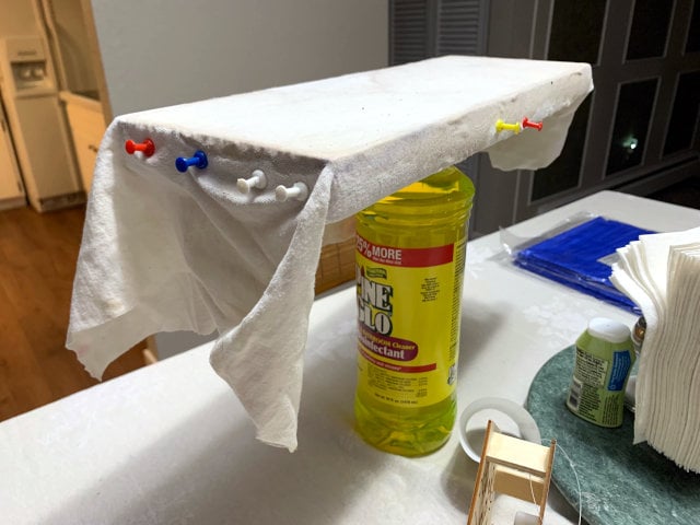

Gluing on the T-Shirt cloth to the XPS foam panel. Use push pins to stretch / hold the material on one side, let it dry 24 hours

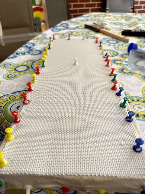

After side one dries turn it over and glue the material to the other side (use push pins to hold it down again) let dry 24 hours. Then I added the alum window screen to the side that will face the road. Use lots of push pins to hold the screen down until the glue dries.

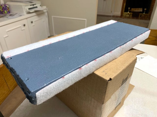

Paint the panel with exterior house paint, let dry then put on the velcro...

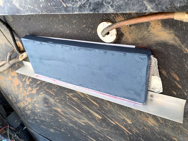

Here it is, in place. The panel weighs 5.8 ounces, the Velcro is rated to hold 10 pounds, and should have no trouble holding this on. Will report back in a few weeks and let you know how it does.

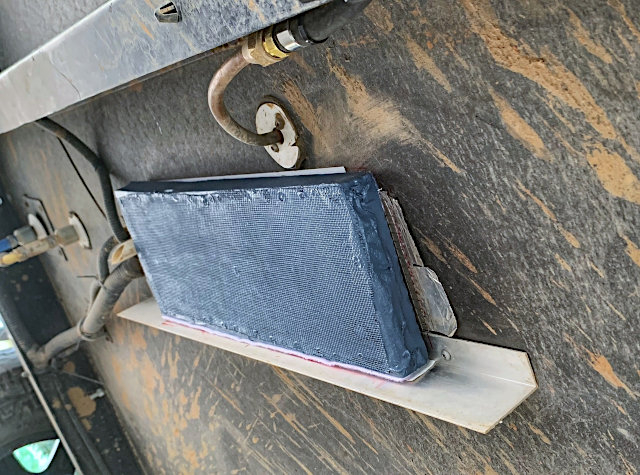

Update: appears to stay on just fine and prevents dust in the cabin when traversing dirt roads (yeah).I have made another panel. 16 inches long by 5.5 inches wide. Willing to send it to anther T@G owner to install. This one will fit / work on a 2021 T@G XL. May work on other T@G's as well.Send me a PM if your interested in it. You do have to crawl under to install/remove - but its still a lot less trouble than hours of cleaning up the dust in your cabin and kitchen.Here is mine after a couple weeks installed:
