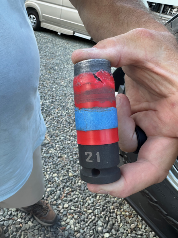

Thanks James! I graduated with a BS in applied mathematics, so I can do the conversions quite easily. The problem is the nut that is holding the tire in place on the side of the camper is larger than a 3/4 in nut. I purchased a generic wheel lock for side mounted spare tires to help protect the side tire and when I went to put it on, I found that the camper does not come with a socket sized appropriately for the nut holding the tire in place. In fact I stripped about 5 mm of the edge facing off of one lug nut using my 4Runner tire iron.I stopped at the dealer where I bought the camper and one of the technicians showed me what he uses and described as an automotive deep lug wrench for 21 mm nut.I have a standard 21 mm socket, and it doesn't fit deep enough into the cylindrical opening to actually grasp the face of the nut. I don't think it is possible and I actually believe the wrong nut is being used on the threaded mounting stud.He said he uses this:
That looks like an impact driver socket.
I use a 19mm for my stablizer jacks, lug nuts and crank for spare tire.
I think I got it from Home Depot.

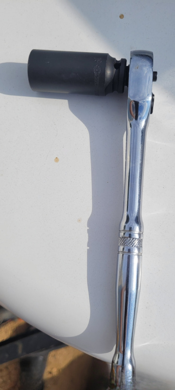

Wow, thank you for the added info. I went to Lowes and picked up a 21 mm deep socket 12 point and a 21 mm semi deep socket 6 point socket. Both fit well within the cylindrical fit, but they actually feel a little bit loose / sloppy. I used the 6 point socket and was able to loosen the nuts. One of the nuts was problematic; I'm 66 and 118 lbs trying to use a socket wrench w/ no leverage, but I did finally get it loosened. The 6 point socket was 3/8 drive. I would have preferred to use a 1/2 in drive, but I didn't have the right adapter. Long story short, is that I think I can work with it for now until I can get the tools I feel comfortable with to change the tire in a pinch.Thank you for sharing your experience and knowledge. It is truly appreciated and helped me to keep moving forward.
