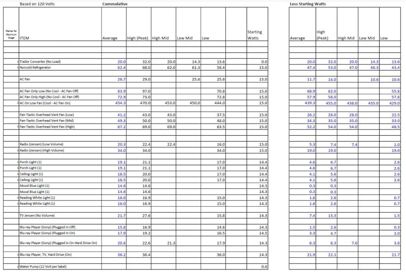

Below and attached is a PDF copy of an Excel spread sheet I put together.
One of my surprises was the power consumption of the Fan-Tastic Overhead Vent Fan.
