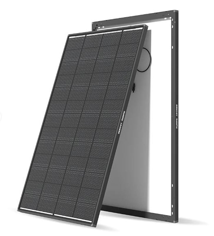

Ordered a Renogy ShadowFlux N-Type Anti-Shading 120W Solar Panel on 11/11/25.
Received two days later and wanted to make sure everything was working and performing as expected.
Purchased directly from Renogy using early Black Friday sale. ($116.99 - Free Shipping)
The ShadowFlux panel incorporates bypass diodes at the panel cell level.

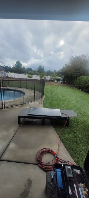

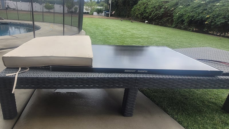

Briefly tested today (11/15/25).

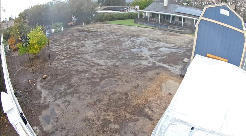

Heavy overcast and some rain. Occasional sun appearances for very short intervals.

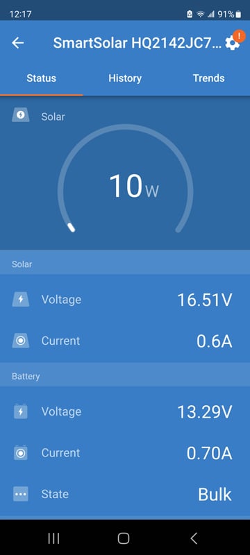

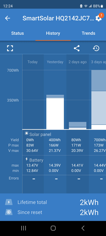

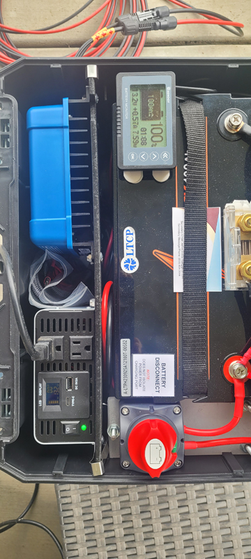

Ran the panel into my homemade power station through a Victron MPPT 100/30 solar charge controller charging a 100ah LiTime lithium trolling motor battery.

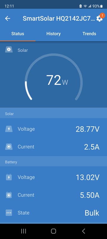

Verification of output using the Victron Connect App and Renogy Battery Monitor with Shunt.
Measured output wattage ranged from 10-watts to 75-watts (average 14-watts with heavy overcast).
Panel was flat for most of the test.
Shading cut approximately the same percentage as shaded area. Unlike early day panels which just 10% of panel shading could result in nearly a 90% or more drop in output.
