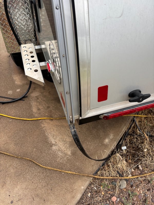

2021 Boondock 5w. Could anyone help me with the proper ordering info for the replacement trim strips that cover the seams along the edges (it's the black plastic strip hanging down in the attached pic). Mine have been crisped in the sun. Thank you.

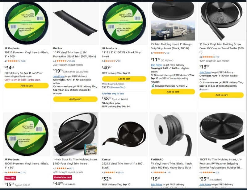

    the entire strip is sold as one piece. Go to the nuCamp online store, browse through the parts section, and you should find the cover strip there.”
  • mariof608
    mariof608 Member Posts: 2
    Edge Trim Cover Strip or Seam Cover Trim / Insert Trim

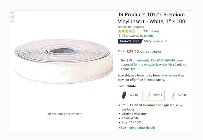

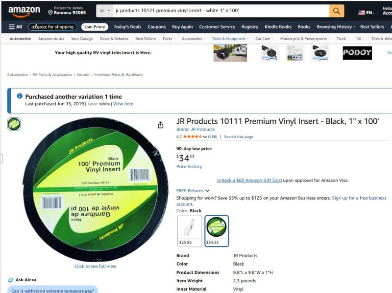

    Do not know the part number for the vinyl insert, but this is what I did with mine.
    My trim is white.
    For black, you pay more.
    You also have options for the type of vinyl and the length.
    I see no need to buy from a dealer.
    Should be an easy install for you.
    Buying a 100' allows for a future install if necessary.
    Good Luck

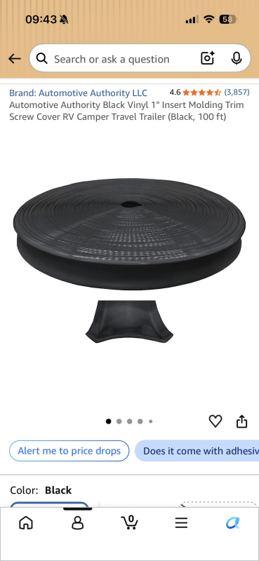

    I bought the below trim a few years ago thru Amazon. The trim on my trailer was originally white, but I opted to change to black. It looks better and I've heard from repair folks that the white is subject to greater UV damage. This is unconfirmed, but the black has lasted longer for me; the original white trim became brittle in less than three years. Average replacement time is 3-4 years, depending on storage conditions and climate.
    After a few years and a rough hailstorm this summer, I just replaced mine for the second time. It wasn't brittle, but the large hail beat up the trim, along with leaving numerous dings in the roof of my trailer. As people have previously noted, it's easier to insert the trim if the weather is warm, as the plastic is more pliable. The real pain is removing and replacing the front handles of your trailer, as the trim goes behind them. Be sure to reseal all the screw holes to prevent water intrusion.
