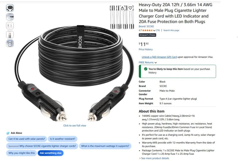

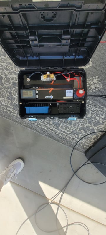

▓ What was never confirmed to me was the concept of using a 12-volt male to male cord plugged into a power station, with the other end plugged into one to the 12-volt outlets of the T@G.
Since I had the need for a male-to-male cord for other projects, I bought one (14AWG) this month.
Today I tested the concept of powering from a power station 12-volt output to the T@G using the cord I purchased.
RESULT:
All 12-volt systems worked flawlessly.
(lights, fan, water pump, refrigerator, USB, stereo, etc.)
I tested my cord by plugging into all of the three different 12-volt T@G accessory ports.
(2 inside, 1 in galley)
Battery cutoff on "OFF"
No shore power
What was interesting is that the converter fan kicked on for a second upon each test.
I would think that the converter would not draw much power in this state and would only present a small parasitic drain on the power station.
Bottom line, it works with ease.
Not knowing the T@G wire size (AWG) throughout, I would assume on the small side (16AWG), which can safely handle 10-13 amps (120-156 watts) of continuous power.
120 watts should be enough to run all of the normal 12-volt T@G needs.
Brief burst intermittent loads can run as high as 180-216 watts on 16AWG.
LESSON LEARNED:
So now I know, I could if needed power my T@G with one of my power stations or even my tow vehicle via the 12-volt accessory port, it is possible.
Keep the male-to-male cord in the T@G in the event of need.
(Note: I forecast no need, but it is an option to have.)
