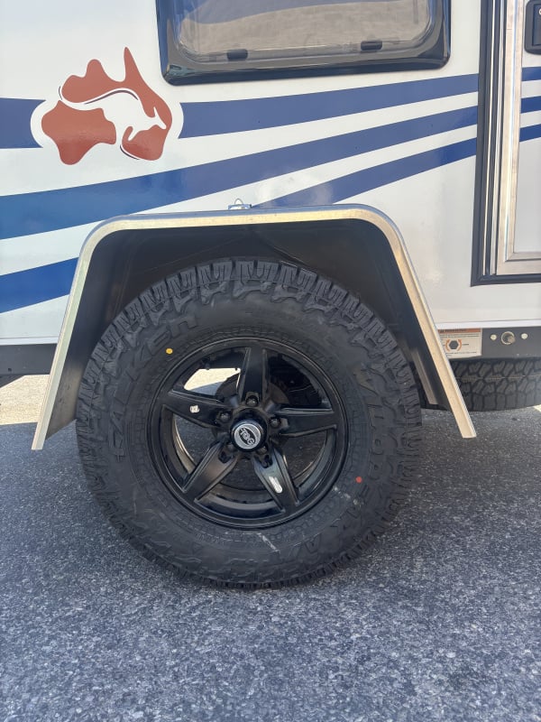

Just replaced the tires on our 2018 T@G XL Outback. The original tires were Westlake 23575R15 special trailer (ST) tires. We had about 3" of clearance on the top of the fender, and about 2.5" on front and back. However, the inside was only 1.5" of clearance. Debated going down to 225 size for a little extra clearance, but found out that we'd be going down to a passenger (P) tire rather than a light truck (LT) tire at that size. The P tires were only 4 ply and the LT's are more like 8 or 10 ply. On the advice of our local tire shop, we went with Falken Wildpeak AT/4W in the original 235/75R15 size. The clearance ended up being the same, so I'm comfortable with the size. We also replaced the spare as it was about 9 years old too. We're running 45 lbs of air for a smoother ride (the tires will hold up to 80 - wow!). Looking forward to trying them out in a week!
Those Wildpeaks are the same tires I run on my Jeep KL (although not the same size). I think you’ll like ‘em.
"If you don't know where you're going, any road will take you there." ~ The Cheshire Cat (Alice in Wonderland) -
Thanks, Dave. Just had them out on their first trip. They did really well and were a smoother ride that the Westlake ST tires. I'm running them at 45 lbs of air. I'm very happy with them.
