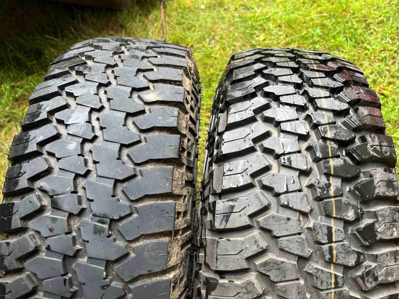

    I rotated our 2024 T@G 5-wide Boondock spare onto the passenger side the other day. Figuring that at 10,000 miles it would be a good time to start the process. It was surprising to find how much and how uneven the tread wear was:
    New/spare on right, passenger side tire, outside on left.
    Driver side has very similar in wear pattern, with inside sipes mostly gone...  This is after only 10k of mostly (95%) highway travel with a well loaded trailer.
    I'm not expecting 50k miles out of these OEM items...  which leads to: what would be good replacement tires? Primarily highway driving, light off-roading (we're not rock-crawling with a Volvo...) definitely gravel roads and seeking the boondock off grid sites. I'm also looking for replacements that would be easy to find (looking at LesSchwab/Discount Tire/Firestone kind of places).
    Are the Coopers still the go to tire in 2025?

    These are the tires I got late last year. - Carlisle Radial Trail HD  ST175/80 R 13  91M C1 (Rebranded as "Carlstar")
    Got the Carlisle tires for $80 each from Discount Tire. Put over 6,400 miles on them this summer. (about 200 miles dirt roads).
    I had no uneven wear on the tires I replaced (changed out because age). Happy with new tires and believe they are better than the orginals.
