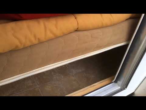

I've had a couple of requests to post a video of the hatch so I made one.
Let's try this and see how it works.
https://youtu.be/mAQth1Ka78w?t=6The video is "realtime" which means I've not sped it up nor slowed it down.
Smooooooth! Thank you @WilliamA !

What I did to insert the video was to (I edited your post William) right clicked on the original YouTube video, selected "copy video URL at current time" and pasted it back into your discussion. That way you see the actual video and can make it run immediately.
2019 T@B 400 -
Amazing. I want this mod! As a newbie, this will have to wait, but not for too long. Thank you.
Cool! Thanks Mike! It's been awhile since I did any linking..
I’ve watched this several times. Each time I laugh hard because it’s so cool. It should be a NuCamp option in the future.

Nice, but this make me think that gaz struts with a good latch could be very interesting. Quick, light and power less.
But nayway, very good job!
