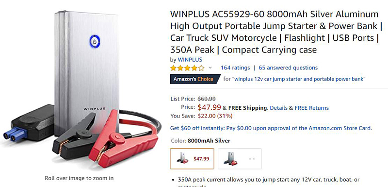

  • JamesDowJamesDow Member Posts: 676
    HikinMike,
    With your battery you should get almost twice the runtime that I have.
    As for relying on the tow vehicle (TV) for charge, like WilliamA, it's a good plan. My problem is that I have a small car with a small alternator. I also do not have the sophisticated electrical monitoring system (which I envy - maybe some day). I have at times left the TV running to do its best to recharge the T@G.
    I often disconnect and reposition the T@G by hand for best location. ■ When I do leave the TV connected and camp, I am always prepared for the time the TV does not want to start. I carry a lightweight portable lithium jump starter. (never had to use it camping) I have used it twice with one of my other vehicles, and it worked great. I just throw it in the trunk and two or three months later it still has the power needed. I recommend. Not only can it jump start a vehicle, it can also recharge other USB things.
  • HikinMikeHikinMike Member Posts: 400
    I have a small unit similar to that as well. I used it to help a fellow motorist. He was driving an F350 with a big diesel engine. When I walked up with my little unit, he didnt believe I would be able to jump start his rig. I had no problem. Those things are a must have.
    2022 Jeep Wrangler Unlimited Rubicon 4xe

  • GigHarborTomGigHarborTom Member Posts: 271
    Thank you guys for all of your technical expertise. I am impressed.
    I also have a battery pack/ jump start/ mini compressor/light/
    It has been my CPAP backup when we are off grid. It was handy at the one nighters at Cabbelas or Bass Pro Shop. It lasts for at least three nights. I was always going to put a 12volt outlet on our previous trailer but --Just another thing to do. Glad to have on the T@G
    I have jumped three big and small rigs. I am on my second unit. I get a low cost functional unit from Harbor Freight.
    On another note, my 4Runner with tow strap, I carry, has pulled out a Class A Motor home up to her axles from the Mud.
