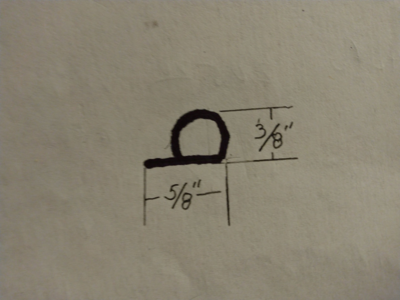

I have been having the same issue with water seeping in at door bottom when towing through rain and wet roads. I can see light coming trough seal at bottom of the door. My camper is a 2014 and seals are compressed. I have been having trouble locating a new "P" bulb seal that is currently installed on door. The local dealer told me that seal is no longer being used. I'm still waiting for a reply from NuCamp.
Does anybody know where I can purchase a new seal for my doors. Pictured is a profile of the original door seal.
