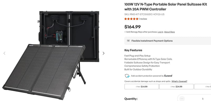

I have had no problems with my Norcold NRF 30. With my 100Ah lithium battery, I can make it 3-4 days even without solar. With a 100-watt solar suitcase by Renogy and full sun, I can last 10+ days. I do usually pack an ice chest with items to drink, and it can keep things cold for 4 days without ice replenishment. After that period, I start moving drink items to the Norcold on an as needed basis. I have always wanted to set one refrigerator up as a freezer and bring ice cream with me to the desert. Having ice for drinks past day 5 would be great.
I now have multiple solar suitcases and other solar panels (100+100+220+120-watts) and solar extension wire to provide for indefinite camping if needed.

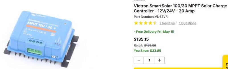

From a solar setup, I believe you may be somewhat limited by the Victron Smart Solar controller (MPPT 75/10). The amp rating of your current controller (10Amp) would not be adequate for another 100-watt solar panel.

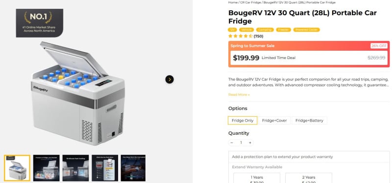

My goal would be to get a refrigerator installed in the T@G. You mentioned BougeRV. I have had no problems with my BougeRV CR28 (30 Qt) and my testing has shown it to be a capable and efficient refrigerator.
Option 1/2 - Existing refrigerator with solar and battery. Utilizing your current refrigerator would require solar panel and controller ($164.99), solar cable ($35) and battery ($330) and battery cable ($12.99). That would cost in the range of $543 (ouch).
Option 3 - New refrigerator installed in the T@G and external solar. Currently the limited time BougeRV refrigerator deal is $199.99. You would need to install some sort of refrigerator slide system. My estimate of the cost would fall in the range of $100-$170. Your current solar panel would be just sufficient, but I believe it should be augmented. I find it best to see the trailer parked in the shade and use a solar suitcase or two with solar extension cables to get those panels directed into the sun. Currently Renogy has a 100-watt solar suitcase with a 20A PWM controller for $164.99. Solar extension cable would run $25-$43 (15'-40') depending on length. I would suggest 20+ feet. My estimate for a new refrigeration installed in your T@G along with solar would cost around $555 (ouch again).

My choice would be for option 3. It provides what you need and preserves your current refrigerator as an extra. Option 1/2 gains you a new battery but cost you space in your Subaru.

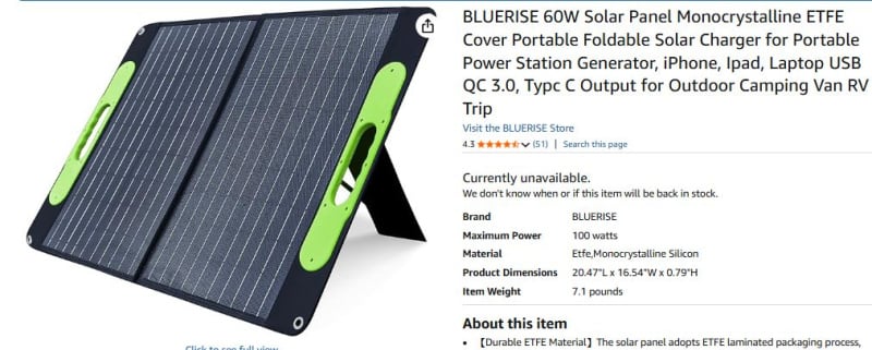

My recommendation would be to stay away from folding laminated ETFE solar panels. My testing has shown the performance is not up to par with the more ridged panels. Some newer panels utilize fiberglass to maintain stability and lightness, but these come with a higher cost.

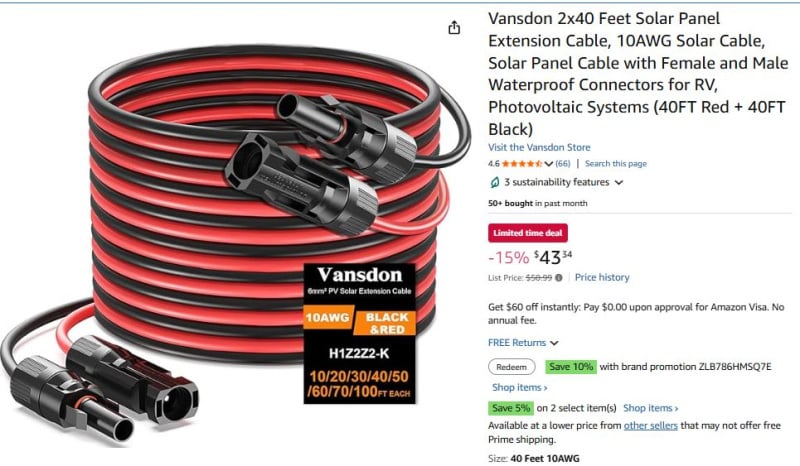

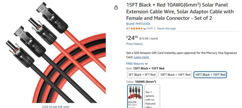

While the cost of lithium was high at the time, I have no regrets. I have never run less than 20% SOC on my camping trips, including a solo 12-day test that lasted 10, because of solar panel shade. Remember I suggested 20+ feet of solar extension cables. I now carry 35-50 feet of solar extension cables. I usually want my trailer and tow vehicle (RAV4) parked in as much shade as possible, because I do a lot of desert camping. (105 degrees plus)
As for how to wire a second rooftop solar panel, that should be easy. If your 2021 T@G does not have an external SAE (Zamp) plug on the site of the tongue box, it would be very easy to install. Mine is a direct connect straight to the battery. From that point, I can connect any solar panel with a solar controller directly to it. I also use mine to charge my T@G battery up to 100% with an external lithium battery charger. It is easy. Using the SAE connector, you would not have the need to upgrade your Victron solar controller. Just use that in combination with your existing solar panel on your T@G. The battery could care less if it is being recharged by one or multiple solar controllers.

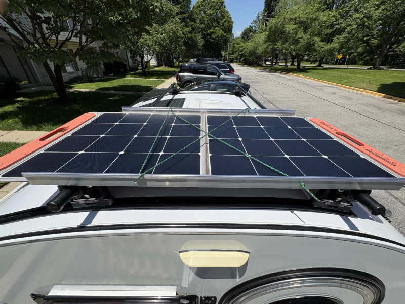

I bought a two Jackery 300w power stations and 100w solar panel, solely to power my fridge. Black Friday is an excellent time, but watch for seasonal sales. I'd consider a higher wattage if buying today (500w/600w). The second power station allows me to switch them for days of consistent rain/clouds. I charge the second one via the inverter in my truck while driving.

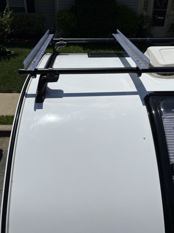

I attached two pieces of aluminum angle to the right/passenger's side my roof rack using light bar clamps, allowing me to place the solar panel flat on top of my trailer. I drilled holes in the angle pieces so that I can use paracord or bungee cords to keep the panel from flying off in high winds. When driving, the solar panel is folded and stored in my vehicle (of course, I don't drive with this panel on the roof!) and the refrigerator is plugged into the trailer. The power station is also stored in my truck to keep it from being damaged. The rack setup is aerodynamic, light, and sturdy.
When camped, I place the power station on my kitchen counter, plug the refrigerator 12v into it, and run the cord up to the solar panel. This works great if I have direct sunlight. If needed, I can take the solar panel down, set it on the ground, and position it to catch the sun.
This has worked great for me. Powering the refrigerator doesn't deplete the AGM battery on the trailer, which I use to run the lights, charge small electronics and run the fan.
