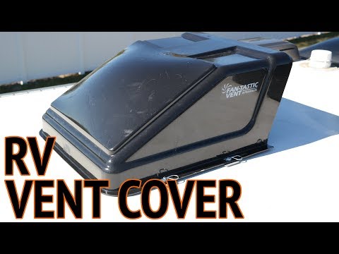

Has anyone installed the Fantastic Vent Ultra Breeze Cover on their Tag?
Looks like work to me! I have installed two of the Aeroflo vent covers and this requires no lap sealant, only installing some small L brackets which isn't too difficult.

This is the one I need to get. The important part of this install video for me was that it is held on with cotter pins. That means that I can easily take it off so I can get Otis in the garage.

After much research and good discussion here, I have installed the Fan-Tastic Vent UB1500SM Smoke Ultra Breeze Vent Cover. I had to order the Maxxair 00-225000 Roof Vent Zero Leak Mounting Kit. I replaced the bolts for attaching the cover to the vent frame with self tapping screws. End result, works great!!
Fot those contemplating this vent, be aware that it comes in a few different models, all of which are less than the space shuttle-ready premium job. The basic model has most of the same features for $160 bucks from e-trailer.
