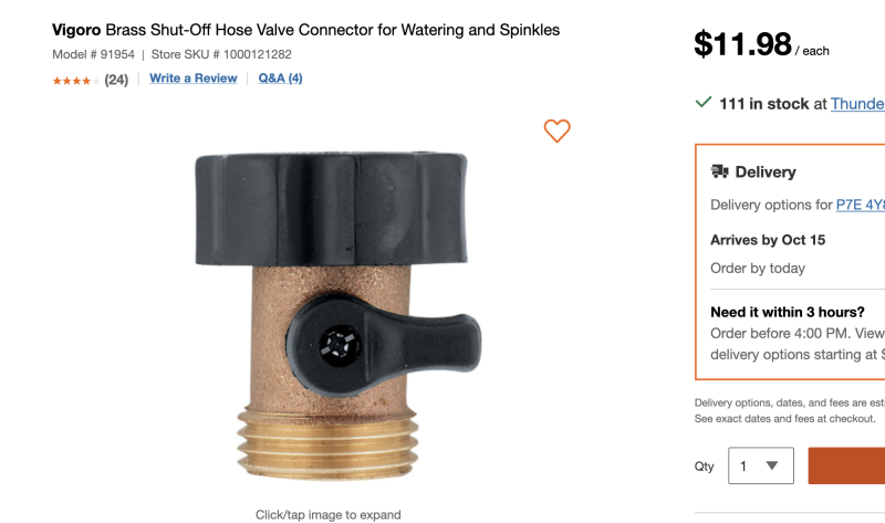

We are new T@G owners and loving it. However, we encountered an issue at the end of a camping trip a few weeks ago; when the pump was activated, water streamed out both the faucet and the municipal water (pressurized) connection on the side of the unit. Tracing the piping suggested that a check/non-return valve forming part of the connection fitting(?) must have failed "open". Connecting to the municipal supply and flushing through the faucet didn't cure the problem so we've contacted our dealer and NuCamp for the repair recommendation. In the meantime, we are using one of these fittings threaded into the connection:
This has restored the proper operation of the system (pending repair) by allowing manual shut-off. It is pretty simple to install/remove (the cover cannot close with it in place) and we've enjoyed the use of the water system on our most recent camping weekend.
It might be handy to keep one in your box of spares.. (Even less expensive in the US) . Dave K
