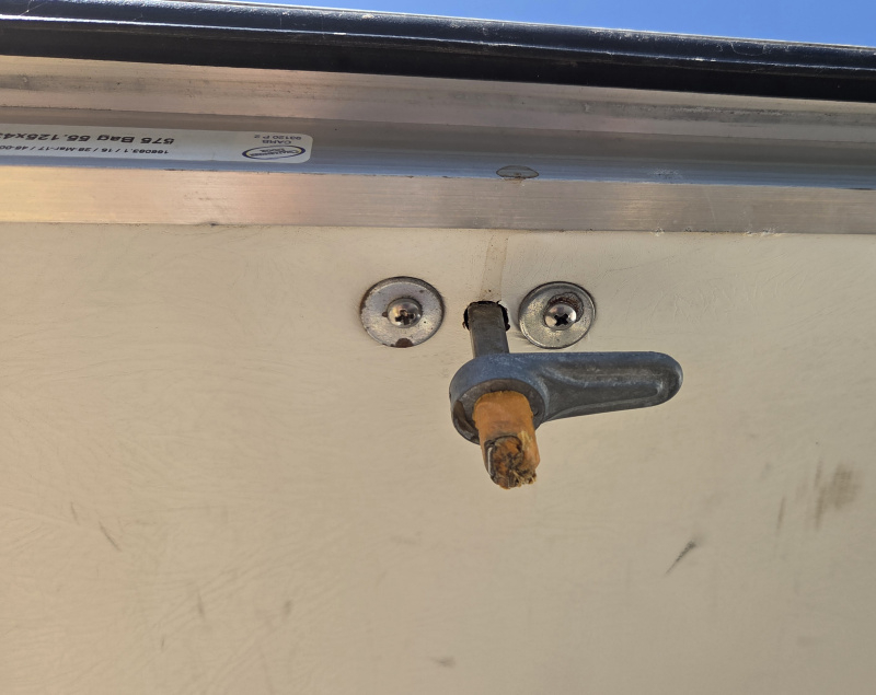

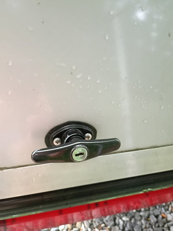

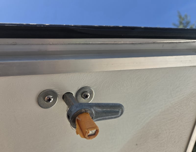

I've spent some time at the lot investigating. The seels all seem tight. On the lower edge with a dollar bill shut in the galley seels, I'm unable to easily pull the dollar out. I have noticed that when shutting the galley, I can easily close the t-handle. When we first bought it, we would lean on the door while closing the t-handle and you could feel the drag of the the cam in the post.
I marked the current position of the cam, loosened the hex bolt and slid it a bit further up to pull the hatch in closer as it latches. We'll see how it it works!

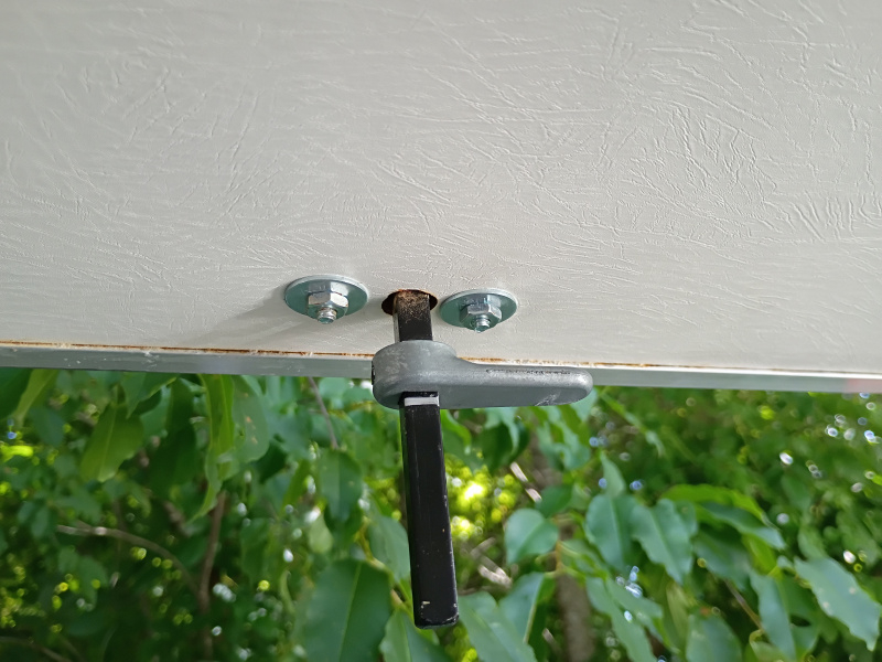

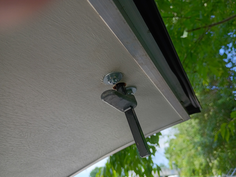

The silver shows where the bottom of the latch was previously. I also ordered some plastic cam plates to replace the washers. Originally, each t-handle had one large washer and one tiny washer. The tiny washer was getting sucked into the hatch. What does everyone else have here on the back of the t-handle?
Note: I have nylon lock nuts but waiting for the plastic cam plate to arrive. These washers were a temporary fix.

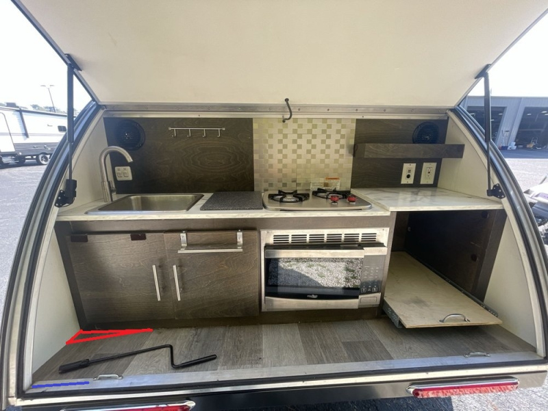

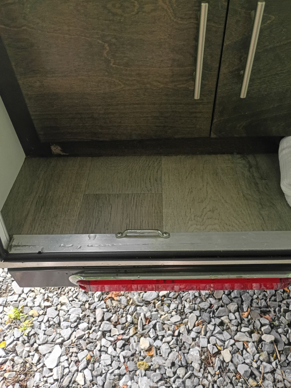

For reference, the water pools where the red triangle is located. The opposite side is dry. Opening the door after a heavy rain I find the sill plate (blue line) has standing water. It seems like that is how the water is getting into the hatch. I did test the seals in that area with a dollar bill and shut the door. The dollar does not move easily when pulled meaning the seals are tight.

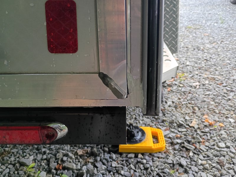

Finally, found the leak! The trailer is parked at a decline toward the driver side. I poured water on the driver channel, t-handle latch and license plate and no water got into the galley. I poured water down the passenger side channel and water is getting into the galley through the seal on the bottom of the door or bottom of the hatch and traveling from passenger side to driver side then intruding in the corner.

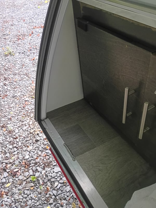

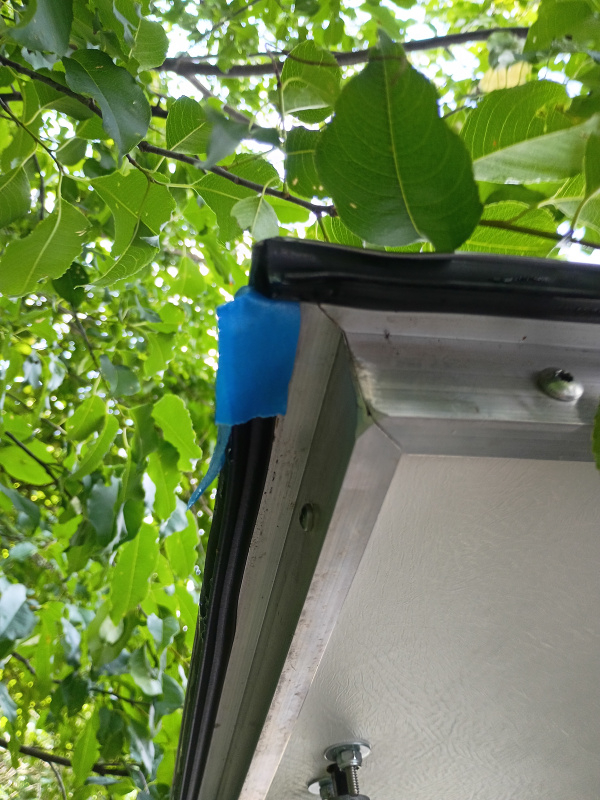

I also found that the seals at the passenger-side lower hatch corner are partially loose:
The seal on the hatch door at the passenger-side lower corner is unglued by approximately 1–2 inches.
The seal on the passenger-side vertical hatch door at that corner is also unglued by approximately 1–2 inches.
I reached out to Nucamp for part numbers of both the hatch and door seals which may need to be replaced. I'm going to use some weather stripping adhesive first to see if that fixes the issue.
I believe the repair may be completed. I reattached the loose weatherstripping on the door with 3M Weatherstripping Adhesive then sealed the bottom edge of the door, where the water channels, with some Sika Pro Select sealant to divert it away from the weatherstripping.

Solved! This FB post put me onto the area of the leak. The metal trim at the bottom of the door has a thin bead of sealant across the top of the trim.
There appeared to be 1 or 2 places along that bead of sealant that had failed. I scraped all the old sealant off using a plastic blade, masked the bottom of the trim and the painted portion of the door with painters tape and laid a thick bead of Sika Sikaflex Construction Sealant down. We had a bad rain storm last night but the galley is dry today.
