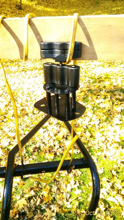

  • WilliamAWilliamA Member Posts: 1,309
    edited October 2018
    I got a warm day so I peeled off the spare tire carrier and painted it up. Here are a couple of different views:
    Here's the Rotopax mount painted up.
    It's all back on and tight. Let it snow....Ughhhhh...Like I could stop it...
    I also got my Lunette and gussets all painted, but forgot to grab a photo or two. I'll get one or two tomorrow. You can just see the lunette in the background of one of the photos...

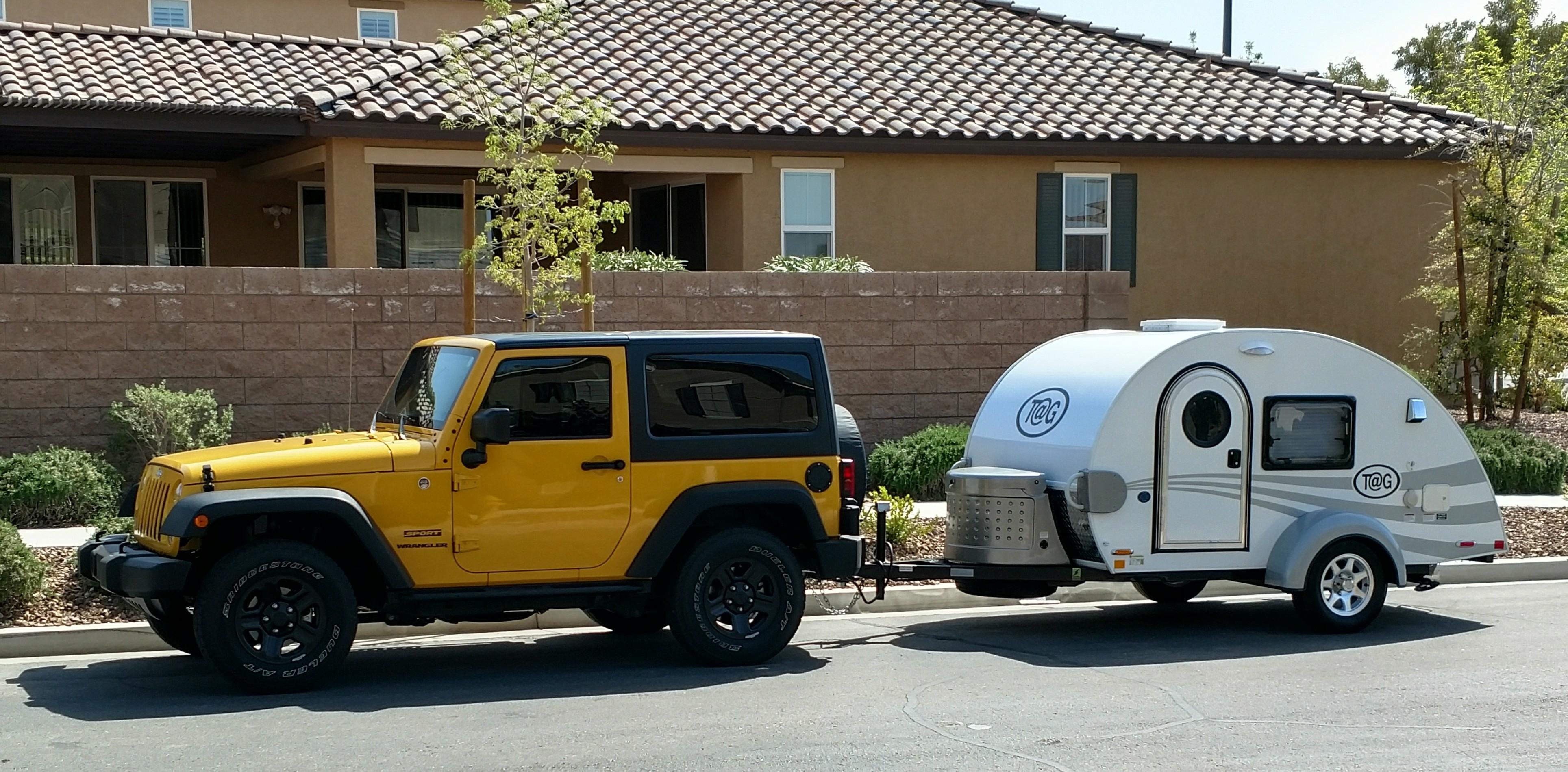

  • JeeptagJeeptag Member Posts: 28
    @CampHub I am looking at your tongue jack mod and am curious where you bought that one. I’m about 1000 miles into my journey around the US and need to be able to open the tailgate of my Jeep to let my dogs in. Making them go in the back from the front is everything but comical. Any brand info is much appreciate.
  • kevineso1kevineso1 Member Posts: 26
    Jeeptag. I too have a Tag Max that I pull with a 2door wrangler. Be happy with your purchase!! I love mine!!!
  • CampHubCampHub Member Posts: 113
    @Jeeptag The tailgate still hits :| even though I can remove the jack tube. I purchased it from e-trailer
    LOL on the dogs getting into a 2 door wrangler! Have fun out there and enjoy =)
    All the calculations show it can’t work. There’s only one thing to do: make it work.
  • MichaelMichael Member Posts: 45
    Just a bit of info. That trailer jack, The Ultimate Trailer Jack, is a stocked item at most Tractor Supply stores. That's where I got mine.
    I normally don't remove mine as it drops down enough so my pickup truck tailgate does not hit it. I realize that may be different with a Jeep.
  • LuckyJLuckyJ Member Posts: 1,239
    This is my solution to the same problem that you have.made that mod the second day the T@G was home from the dealer. As it is, I can open my tire carrier all the way and also my tailgate form my wrangler.
    I did mod it some more since. But to me, it is a no turning back solution. :)
    edited June 2019
    @kevineso1 I’m not complaining about my awesome trailer just trying to figure out if I can do something different with my jack. I have the back seat out of my Jeep and that’s my cargo area for my travel partners. My Aussie can’t grasp getting in the back without making a scene.
    @CampHub where does it hit? Right now I can only swing mine open about 12 inches and I have to pick up 60 lbs and squeeze them in. Mine is hitting on the spare.
    @LuckyJ did you cut and weld that into the trailer tongue? I have considered buying an extension bar but I like keeping the fewest points to fail as possible.
    @Michael thanks for that info I’ll look into that jack

    So I ended up driving to 3 different tractor supply stores to find the ultimate trailer jack. Installed it in about 3 minutes. When I stop at a gas station or dog park I can drop my jack to the ground and it gives me enough clearance to open my tailgate a few feet. How long will the jack last? Only time will tell but so far I am happy with the results
