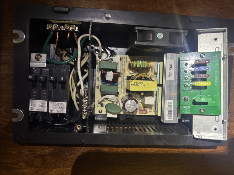

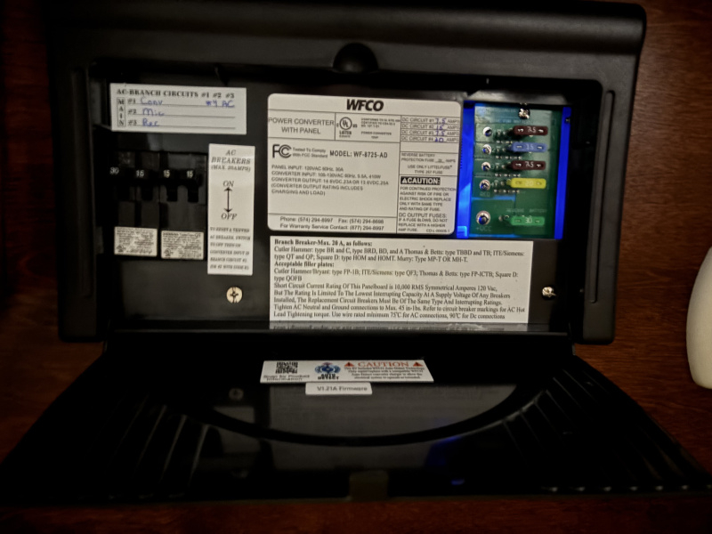

    Well... I swapped WFCOs today, and it was a touch more of a pain than I expected, because of the way the AC side was wired. But the deed is done, and now according to my trusty Fluke multimeter, the charger output to the LiFePo4 battery is a solid 14.6VDC in Bulk mode and 13.6VDC in Absorption mode, with no equalization mode at all to worry about... Just what the lithium battery loves.
    Part of the fun was due to the camper being parked in the winter storage yard, with no AC power anywhere near it, so I had to drag my generator over there to run my soldering iron & heat gun for the heat-shrink tubing, plus have a reliable 125V 30A service to test the finished job. It's also not the most convenient or comfortable position to be in for working on anything, sitting inside on the floor for an hour or two with my arthritic knees jammed into the bulkhead wall.
    Here are the two power centers at the beginning of the adventure.
    Wires-Я-Us.
    The Finished Product. Note the two amber LEDs lit up on either side of the battery switch at the top of the DC fuse board; those indicate the unit is set up for LiFePo4 batteries and is charging in the higher Bulk mode; when the LED on the right side of the switch goes out, the charger has dropped into the 13.6VDC Absorption mode.
    "If you don't know where you're going, any road will take you there." ~ The Cheshire Cat (Alice in Wonderland)

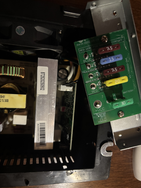

    Hi Everyone. I finally upgraded my 2018 T@G to a lithium battery too. It was a little bit of a saga, but it's done and I'm happy for that. Here's my experience...
    I ordered a WFCO 8725-AD - the lithium only models seem to be unavailable now. I did confirm with WFCO technical support that the one I received has the latest firmware and hopefully doesn't have any of the issues earlier models did with the autodetect. I'll update this post once I can confirm the autodetect is working properly.
    After reading The_Rigger's post about the AC wiring, I was a little concerned about what I would find and what the best way to wire the new unit would be. The manual for the new unit indicates that the 30 amp first breaker is for the entire unit and that the AC hot should be fed into this breaker which, in turn, supplies the hot to the hot bus bar that the two duplex breakers are mounted on. These instructions seem to comport with what The_Rigger saw when he replaced his unit. However, it doesn't appear that his was wired 'backward' from NuCamp, but rather that NuCamp followed the WFCO instructions on how to wire it. Thus, three breakers are left for the other AC circuits when wired this way.
    The WFCO 8725 in my 2018 T@G Outback was wired differently. Behind and to the side of the hot bus bar that the two duplex breakers plug into was an additional 'ear' with a hole and set screw into which the hot wire from the AC supply was mounted. So my AC hot was wired directly to the hot bus bar and not through the first 30 amp breaker. The 30 amp breaker was wired to the converter (AC to DC side), and the other three 15 amp breakers supplied the microwave, outlets, and air conditioner. The new 8725-AD did not have this extra ear for the AC hot wire, so I was initially unsure how I was going to wire the new unit. However, I discovered that if you take out the two phillips screws holding the breaker bus bar to the unit, the extra ear was a separate piece and that the new unit had the proper cut out in the plastic housing to fit this extra ear. So I removed the ear from the old unit and replaced it in the new unit, and I was able to wire the new unit the exact same way as the old unit with the AC hot going directly to the AC hot bus bar for the breakers.
    I could have wired my new unit the same way The_Rigger's was wired, and it would have been perfectly fine that way too - I would have just lost a circuit (I removed my microwave in favor or more storage so I could have deleted this circuit if I needed to). Either wiring method achieves the same result of supplying AC hot to the bus bar. The only difference is that one way creates a 30 amp main breaker for the entire system, and the other way has four separate breakers for each circuit. Neither is right, and neither is wrong - they are just different. I confirmed this with a friend who is a retired electrician who worked at Hoover Dam for 20+ years, so he knows high voltage circuits and electrical safety well.
    The one potential downside of the method WFCO recommended for wiring is that with a 30 amp breaker feeding the entire system, the sum total of the amperage drawn by all of the other circuits must be less than 30 amps or that breaker will pop. So with the AC/DC converter rated to 25 amps and three other 15 amp circuits, they could theoretically exceed that 30 amp breaker for the whole system. I feel that most of us are unlikely to be simultaneously running all of the circuits, but it could theoretically happen.
    While I was installing the new converter, I discovered that NuCamp took some shortcuts wiring the DC side of my converter. They had bundled four of the circuits by feeding three wires into a butt end crimp connector (bad practice) and then had the one wire coming out of the other end of that butt connector and a fourth wire going into another crimped butt connector and then connected to the converter. Needless to say, one of the three wires going into the first butt connector was lose (you can't use butt connectors for multiple wires). So I took the opportunity to rewire this portion of the DC side. I also cleaned up the DC negative bus bar. It was a rats nest where they twisted several negative wires together and fed them into a single connector in the rather large bus bar. So I put ferrule's on the ends of each of the stranded wires and put them each into separate connectors on the bus bar resulting in a much better wiring job. For the positive leads, I use WAGO Lever Wire connectors. These basically work like mini insulated bus bars for the hot side of the DC. I was looking for a good solution for the multiple wires combined to one lead to the converter, and I ended up using a 5 lead, a 3 lead, and two 2 lead connectors. I definitely recommend these. Just make sure you get the genuine ones - there are lots of knock offs online. The genuine ones are made in Germany, and Peppy Products is an authorized packager/reseller on Amazon. I also found them at Ace Hardware, but only in a few sizes. Amazon has kits of varius sizes and quantities. Look forward to using these in more projects.
    One thing I noted when I powered up the new unit. I turned on the battery and confirmed the DC side was working properly before connecting AC and turning on the AC breakers. Satisfied that the DC circuits were all working fine, I plugged the AC in and turned on the first breaker for the converter. I was greeted with what looked like a green and orange lights on the panel (actually behind the panel - on the 8725-AD the lights are behind the circuit board and not on it, so you have to view them through a slit). I also heard what sounded like crackling behind the circuit board with the DC fuses. I was concerned that this was a malfunction (after all of that hard work installing it!) and turned off the AC breaker to the converter. After a few choice words and a myriad of scenarios ran through my mind, I turned on the AC breaker again and only the green light was visible and no crackle. Having Claude.ai search the web and forums, it appears that what happened was that on first power up I still had the battery disconnected - which is fine, the converter is designed to work with or without a battery. But on this first power up it was trying to find a battery, determine its chemistry, and initiate bulk charge. What I likely saw through the slit wasn't an orange light but the green and red lights (green for lead acid battery - I hadn't switched to my lithium yet and wanted to confirm system function before switching, and red for attempting to bulk charge). The crackling was likely a combination of the transformers and relays working to try and sort out the system setting on the first power up. Likely my powering down and powering back up the converter side settled it down into a normal state. I described this experience to a WFCO tech, and he did not seem concerned that there was a malfunction. He said that they had not heard about crackling occurring on first start up, but he wasn't concerned it was a fault or short. If anyone has had a similar experience, please let me know. I expect the technicians know a lot about how it is supposed to work but probably lack a a lot of real-world experience with how units actually work.
    I've now switched out my lead acid battery for the new lithium one (Renology 100ah with Bluetooth). It's at 75% charge and, per the WFCO tech, I'm letting it discharge to 25% before plugging the AC in so that the autodetect will see the large current draw when it starts charging and recognize it as lithium. I'll update this post once I plug the AC in to let folks know how it went.
    Hope this helps anyone looking to make the switch. Glad to be a part of this community!

    Well, long story short, the autodetect algorithm did not detect my LiFePO4 battery at 30% charge. I did some deep dive research with Claude.ai, and its assessment is below, which indicates that the jumper to force the 8725-AD into lithium mode exclusively is the answer. I had confirmed that my unit had the new firmware (from a tech at WFCO), but the firmware itself isn't enough to reliably force the converter into lithium mode. My next step will be to call WFCO and request the jumper. I'll update more after that step. Below is the AI assessment of the situation:

    • Absorption charge voltage: 13.6V
    • Storage charge voltage: 13.2V / X (the X indicating lithium has no storage mode)
    This reveals something we hadn't discussed — in proper lithium mode the WFCO targets 14.6V, not 14.4V. Your Voyager solar controller is set to 14.2V. So the WFCO with jumper would actually charge your Renogy to a slightly higher voltage than the solar controller does. Both are within the Renogy's acceptable range.
    Was Your Unit's Behavior Appropriate?
    Technically yes — the converter behaved exactly as its design intended. The manual even states: "Regardless of charge profile (lead-acid or lithium), your battery is safe from harm and will still charge." The converter wasn't malfunctioning — it was doing exactly what its algorithm told it to do. The problem is that its algorithm was not designed with LiFePO4 BMS behavior in mind.
    Practically no — for your specific use case the behavior is completely inadequate:
    • Without sustained bulk charge mode the battery will never reach full charge on shore power
    • The green LED means charging is optimized for lead acid chemistry, not lithium
    • The 13.5V power mode voltage provides only a trickle to a LiFePO4 that wants 14.6V for proper charging
    • Every time you plug into shore power the same sequence will repeat

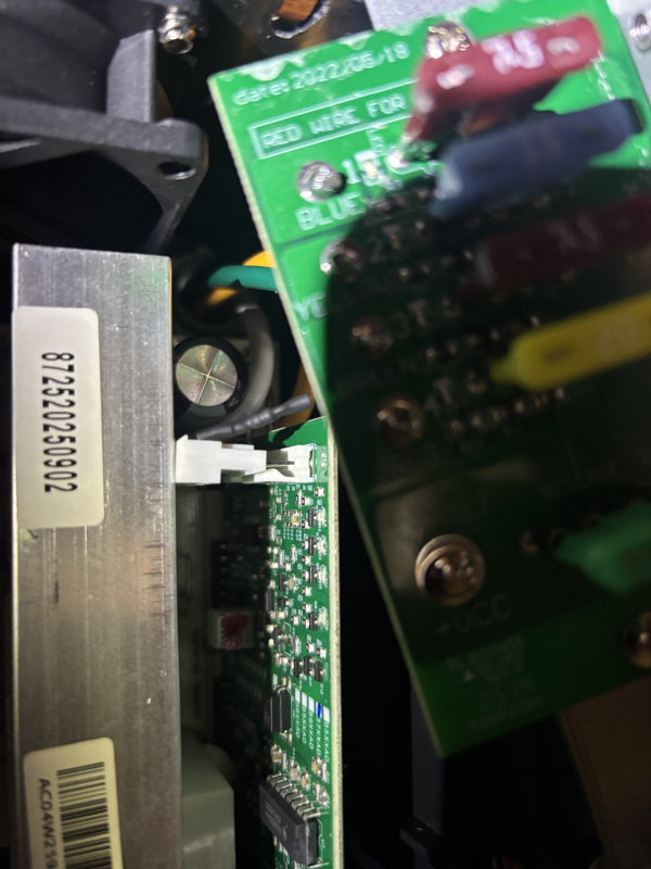

    The Jumper's Role — Now Fully Understood from the Manual
    The jumper bypasses the entire auto-detect sequence described in the manual. With pins 1 and 2 jumpered, the converter skips power mode and auto-detect entirely on startup and immediately enters lithium charge mode at 14.6V with maximum available current. The LiFePO4's BMS will still manage actual current intake, but the converter will sustain its 14.6V target voltage throughout, correctly delivering a complete two-stage lithium charge cycle as described on page 6.
  • nism
