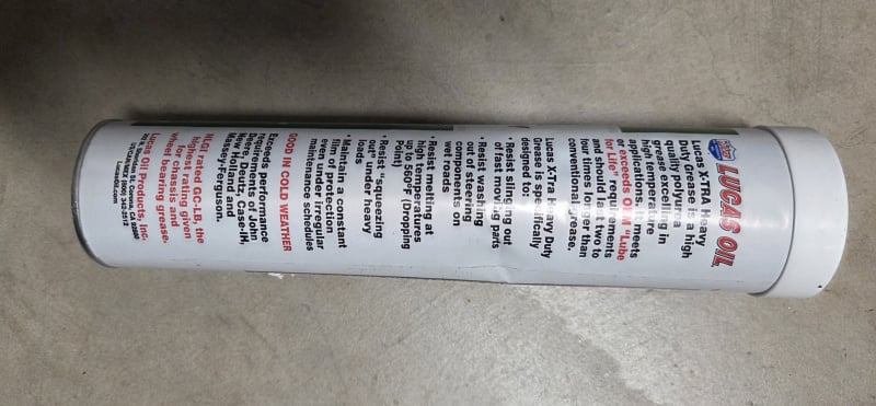

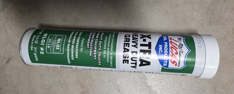

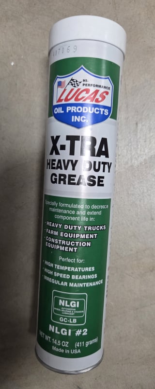

Below (photos) is what I use.
PROCESS:
It is important to spin the tires when adding grease. Thin latex gloves are good to have and some newspaper to protect floor/ground. What you are doing is pushing out the old grease. (When grease is pumped into the fitting, it is channeled to the bearing and eventually back out the grease cap hole). Be cautious of some sharp edges inside when cleaning up. Everything you will be doing is outside of where the bearings are. Pump out any air out of the grease gun.
Pop plastic (T@G) cap off with flat head screwdriver. Next, using screwdriver, pry off the black rubber grease cap (about 1 1/4" dia.). Now you should have access to grease fitting. Up to this point all is external to bearings, so should be clean. Push your grease gun onto grease fitting (click). Start slowly turning the wheel and pump the new grease in. (New grease should not be escaping immediately if grease gun is attached to fitting properly). After a short while the old grease will start pushing out. It may be different color than what is being pumped in. You can use some paper towels to wipe it away as you proceed. Pump some more in to replace old and you are done. Remove your grease gun. (May take a little effort) Use paper towels to clean up any grease mess, replace rubber cap. Clean up 100% of any grease (watch sharp edges) replace plastic T@G cap and crank back down the tongue all the way and crank up stabilizer. One side done, repeat on other side. Entire process less than an hour.

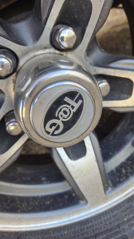

James, we also have a 2018 T@G, but the boondock model. I just had to pull off the wheels to replace the brake magnets and it seems the plastic cap on my wheels can only be removed by pushing it to the inside after the wheel is removed. There is a grease nipel in there but i dont see how to access it without pulling off the wheels.
Please ignore my previous post. I just figured out the silver plastic disk with the T@G logo pops out off the plastic cone.
