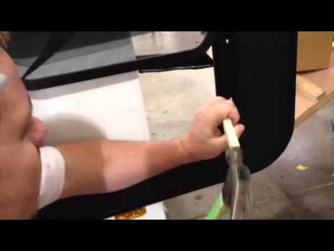

We recently spent a day driving through powerful mid-west storms. When we stopped for the night, we discovered that the bed was soaked. Water had obviously come through under the door on the left side of our t@g. A wet bed (my side, of couse) was not the way to end a stressful day of travel. Has anyone else had this experience? The seal around the door is not cracked or loose so we are unsure what to do to remedy the situation.There are various reasons this could take place. In some instances it is created by owners when comforters are added to the trailer, bedding is tucked in between the mattress and door, etc. Another area t consider and look at is the window since the above issues and subsequent pressure against it can loosen the glass panes, allowing water to seep in and get things wet.
Here is a video that explains the window and how to adjust tension.
https://youtu.be/1m_2Nd_lieY?t=5@Bee said:

The first time the bed got wet, we thought it might be because of the comforter, so I was careful from then on to pull the bedding out of the way before shutting the door. That’s why I was very surprised when the bed was wet the second time after I had been so careful. Our tag XL has the little round window on the door and does not have the window shown in the video. None of the walls were wet, the ceiling/fan were not wet, and the storage compartment under the bed was not wet, so we concluded that the rain had to be coming in at the bottom of the door. The seal appears to be correctly installed.
