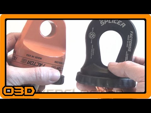

I'd take a dozen or so photos and demonstrate, but it's easier to just post this link to the video I watched. You can get to the rope repair How-to about halfway through. CPO uses a sort of knitting needle end device to thread the rope through, but I just did a tight wrap of masking tape on the end of the rope so it came to a point and it worked fine for me. It would take a bit of experimenting to get the lengths right, but it's easy once you get the hang.
The one thing CPO doesn't cover (as it doesn't apply for winch rope) is that most braided ropes used for smaller jobs have a solid center core that needs to be cut off about 6-8 inches back from the end in order to be able to loop the end back within itself. As I said, a bit of experimenting is in order to get the length right but it's pretty obvious how much needs to be cut off. To cut the center core out, take a small straight tool of some kind and go back 6-8 inches from the rope end, then work between the braids of the rope until you can poke the center rope out the other side, then cut it off. Yes, this will make your rope that much less strong, but I'm assuming you aren't using it for either rappelling or winch duty.. It will still be mucho plenty strong for holding down an awning or tent corner.
https://www.youtube.com/watch?v=L-uYHCCzmcE
