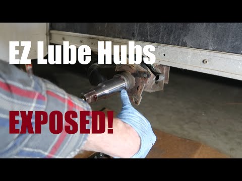

    csonni Member Posts: 354
    This is rather concerning for those of us who rely on the EZ Lube system. Is the grease actually doing it’s job? https://youtu.be/1B_E7khBenQ
    edited July 2021
    Just saw another video where the guy repacking the bearings is trained by Dexter. He says the EZ Lube system is strictly for emergency use only. Pumping grease through the system will most likely get past the wheel seals and contaminate your brakes.
  • HellFish
    HellFish Member Posts: 140
    Hard to REALLY know. But the guy in the video was greasing a disassembled unit. No way the grease was gonna go into the bearings. An assembled unit forces the grease into the bearings and around the spindle. I don't think this was a fair test at all. I do think you have to be careful to slowly pump the grease into the zerk so as to not create an overpressure which forces grease past your inner seal and then into the brake/hub area. Otherwise, I am confident in the Dexter system. I could change my mind on this, but the video certainly didn't do it. The guy made assertions, but no proof.
