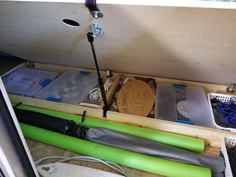

I have a bad back and accessing the under bed storage would cause me pain and spasms. The lift cup installed by NuCamp was located in an awkward spot, so having seen a mod done by another T@gger using a strap and cane props, that was what I thought the solution would be. Worked fine unless the cane prop was dislodged, which of course caused the bed platform to come slamming down. If I had to hold the bed platform up, my back would spasm. Needed a new solution....Pneumatic Gas Lifts. They work perfectly and no more back pain for me! Here is a video showing my process.

Yes, I think the pneumatics would work with the piano hinges, I don't know though since I removed the 3 mini piano hinges installed my NuCamp when I installed the cabinet hinges. Since I will still having issues with the propping situation, I installed the pneumatics with the cabinet hinges in place. You can see them in the picture with the green pool noodles. I like having the bed platform separated. I think the cabinet hinges give good stability.
The 3 hinges hold the two pieces together but don't hold them down to the base. I added the pneumatics with the three hinges only and the other side started to lift. I then added the new hinges. I used 27" pneumatics at 80 lbs for higher lift and was able to move the pivot point closer to the middle of the trailer to open up the access. Thanks 1luvFishing for the video, works great.

I know this is an old thread , but thought I would try a question. Replaced the piano hinges with cabinet hinges as did 1luvfishing. Then installed the same 80 pound gas strut. The strut unfortunately pushes the bed support to the outside so that it overlaps about 1/8 inch and will not close. I either need to reposition all my hinges or take some off the edge of the bed board. Suggestions?
Trim off 1/4" to remove the overlay
You may have to add a couple of hinges just to tie the plywood firmly to the divider. I used larger piano hinges and made some some 90 degree metal tabs (one of WilliamA's mods I believe) to fasten the hinges to the long central divider. One leg of the L has a hole that the hinge pin goes through and the other leg has two screw holes. Added one to each hinge, works perfectly.

I readjusted my hinges a bit and planed about 1/8 inch off the lateral side of my under bed door and it seems to work ok now, using the cabinet hinges. Evidently the force of the strut pushes the spring in the hinges out a bit.

1luvFishing , great video... Doing my research I found that the gas strut should be installed with the tube on the high side and the piston pointing down... I attached a file for information... Happy Camping...
