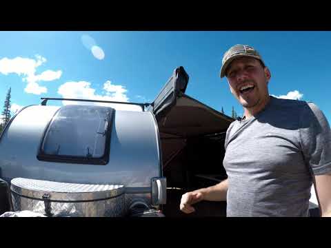

    https://youtu.be/B1AJr9yWRWM
    I’ve seen this video post from Josh St. John on YouTube. He has used a Batwing with his T@G. Check out the link.
  • PamPam Member Posts: 16
    Thank you! this is the post I saw that made mw want to get the Batwing! He seems to have no problems, but later investigations have raised concerns
