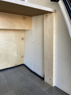

Also, If you haven’t braced the right side of the back shelf yet, get ready because the screws are gonna rip out of the wall and the shelf will sag. Make a template with cardboard first since its a wonky area. glue the board to the wall and pin it by drilling and gluing some ribbed paneling nails top and bottom into the floor.

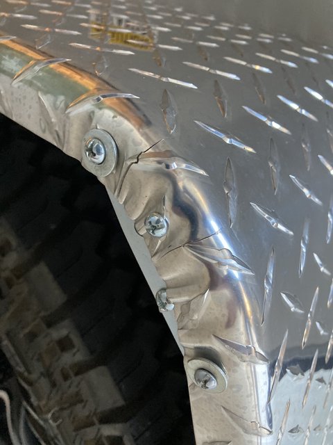

Wait until your fenders look like this from the vibration

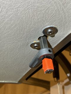

Anyone recognize this ?
Pull the hex set screw out of the latch, put loc-tite on it, put it back in tight, apply a couple of wraps of tape to the shaft so it won’t fall off the shaft if the set screw loosens. you can even put a spot of tape over the set screw, i took it off for the photo. If you don’t...You’ll be sorry !
This is really unacceptable for a trailer that costs so much. I've had nucamp replace mine twice already! You should contact your dealer as mine was replaced under warranty!
Correct, but I fixed it for good out of my pocket per my other thread. I’m not going to keep getting the factory beer can fenders fixed as I have other things to do. They make better fenders that would replace those exactly that would never split. I just decided to go frame mounted and steel with step.
https://teardrop-trailers.vanillacommunity.com/discussion/1234/t-g-fenders-fixed-for-good#latest
About the fenders, it almost seems that the checher plate model are very weak compare to the none chekered model. Our none cherkered are on a 2017 and have seen a lot of travel, imcluding some dirt road at fairly good speed, and so far, tge front looks bad from being it with rock, but still not even a singke crack in the bend.
That is correct, its a chicken crap thin diamond plate.
